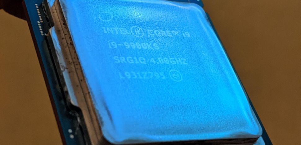

This specially-binned chip got as quick as 6.95 GHz on all of its cores.
Intel's Core i9-9900KS is the company's fastest consumer CPU, a version of the high-end 9900K that has been highly-binned so that you get only the most-capable chips from the factory. Every 9900KS is rated to hit 5-GHz on all eight of its cores and, in Tom's Hardware's review testing of the 9900KS, we were able to hit a strong 5.2 GHz. But that's chump change compared to what you can do with the best 9900KS chips and the liquid nitrogen cooling.
To show us how much its chip is capable of, Intel sent Tom’s Hardware a hand-picked Core i9-9900KS sample for overclocking testing, which when combined with our expertise, reached a gob-smacking 6.95 GHz on all cores and 7.3 GHz on just one thread. Intel has previously tested this part for overclocking. While Intel does not guarantee overclocking frequencies, Intel expects that the test results for this part will exceed those of an average sample.

Let’s start by looking at the physical differences. Temperature is a key factor in overclocking, and obviously the thermal transfer from the integrated heat spreader (IHS) to the cooler plays a major role. Thermal paste fills any voids between the cooler and the IHS, and you’ll need to use it if you like to keep your warranty on such things. But if you flatten both surfaces so the thermal paste is as thin as possible and uniform throughout, there are always temperature improvements to be had.
Speaking in generalities as my sample size is fairly limited (three Core i9-9900KS and 20 i9-9900K), the average die temperature on the 9900KS seems to be exceedingly lower than the -9900K units I’ve tested. Intel provided me with one of the 9900KS samples, but it exhibits the same thermal characteristics as the other two, which are both retail.
My first step is always to flatten (lap) the IHS by sanding it on a true flat surface with various grits of sandpaper. My liquid nitrogen pot is flat, so a flat IHS provides the best mating surface. Some CPU waterblocks are “bowed,” and many are concave. This happens sometimes by design, and other times by the nickel plating being thickest at the edges of the cooling surface.
Below is a picture of four 9900K P0-stepping units that exhibit the same IHS pattern. You can see where the copper shows; those are the high spots, while the nickel portions are the lows. All four have high edges and are concave in the middle. This will result in a thicker layer of thermal paste in the middle, but thick is not going to help us.
The 9900KS R0, as seen below, is very uniform with just a pair of slightly low edges. All three of our samples were identical in this regard. Normally, flattening the IHS lowers temperatures by as much as 4-5C on the warmest core, as well as resulting in a more even spread of temperature between the dies.
Here is our finished product below. I gained absolutely nothing at all on water cooling with the 9900KS. As I stated before, my sample size is so small that I can only speculate that the IHS seems improved from the factory over the 9900K.
After a test mount of the CPU pot, we can see an optimal thermal paste spread and a very even application. A perfect mount!
